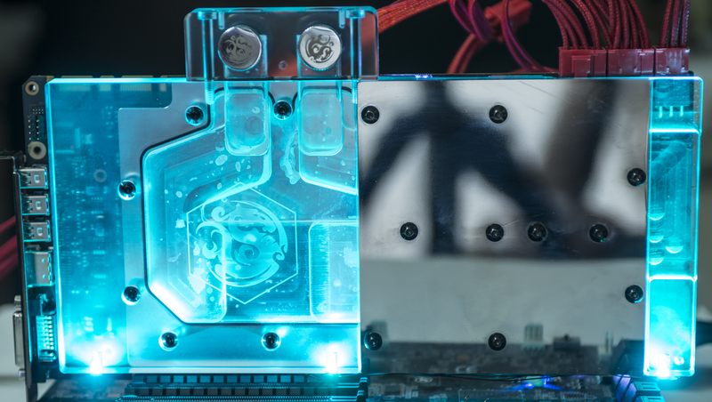

Watercooling compatibility
THE EK-FC980Ti Classy/FC780 GTX Classy - Nickel WATERBLOCK DOES NOT FIT THE 980Ti KINGPIN GPU! Location of mount holes and VRM circuitry is competely different to 980Ti Classy/780Ti cards..
Bitspower 980 K|NGP|N waterblocks are compatible with GTX 980 Ti KPE, with minor limitation.
Due to different memory chip layout - few memory chips will not be in direct contact with block. That's not actually an issue, as memory is not power hungry device and does not need direct active cooling. You can add thermal pad between extra chips and block, so nothing to worry about there.
Here's example with BP 980KPE block installed on 980 Ti KPE:
We will use native EVGA KPE backplate, to keep access for switches and LEDs. In such case stock screws should be used to mount block, as Bitspower screws are made longer to fit with thicker BP backplate.
Installed block, front & back side
BP block is not exactly single-slot, like EK, but still much thinner than stock fansink solution.
DIY RGB lights for waterblock setup (BP) or casemodding
Bitspower waterblock have spots for 5mm LEDs on bottom edge, so it's a perfect candidate for RGB LEDs, for casemodding and custom chassis systems.
To connect LEDs, we use same connector type as ProbeIt, but with 4-pins only.
Following simple schematics as shown, connect your custom RGB LEDs with 20-47 Ohm resistor in series.
Now you can use Precision X to adjust LED settings. As example, to set rainbow effect, cycling all colors, use Demo2 setting:
Result could be similar to photo below:
You can connect each LED to separate port (connectors J17,J18,J19) to control LEDs individually. Only your imagination is a limit for color scheme.
Here's prompt YouTube video on click showing completed mod with three RGB LEDs fixed on BP block and controlled by RGB connector on PCB.
